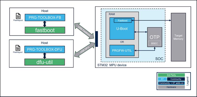

STM32PRG-TOOLBOX provides an open-source tools for STM32 Arm® Cortex® MPUs to flash and update the target flash memory using Fastboot mode.
This package is composed by:
- PRG-TOOLBOX-DFU: to install U-Boot, launch Fastboot mode and manage OTP.
- PRG-TOOLBOX-FB: to flash memory partitions through Fastboot interface.
The user can start from these preconfigured projects to configure its STM32 Arm® Cortex® MPUs and customize the boot/flashing sequence corresponding to its specific use case.
