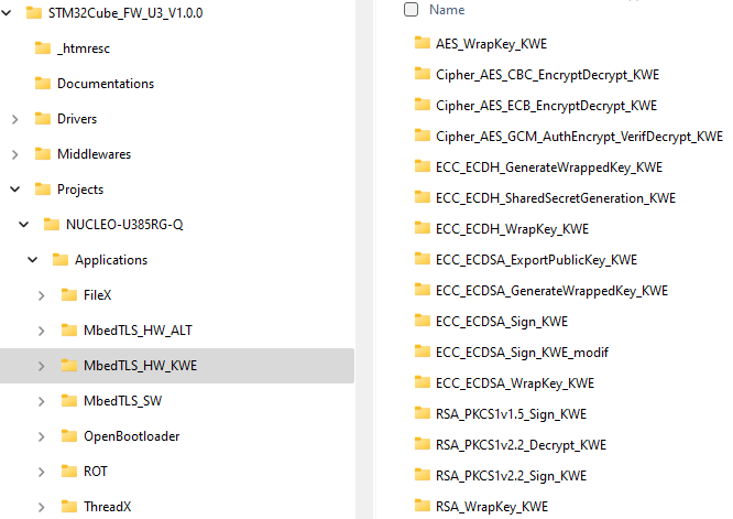

- A directory NUCLEO-STM32U385RG-Q is included in the CubeFW Projects directory.
- The Applications\MbedTLS_HW_KWE directory contains the different application examples using wrapped keys.

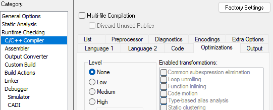

- To run this example instruction after instruction it is advised to change the optimization to "none", as shown in the figure below:
- Compile the project: Project -> Rebuild All
