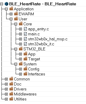

2.2. Application
Application is the core part of the project. It groups all the main information and actions that define the user application. This section is divided into sub-directories:
| EWARM project view | |
