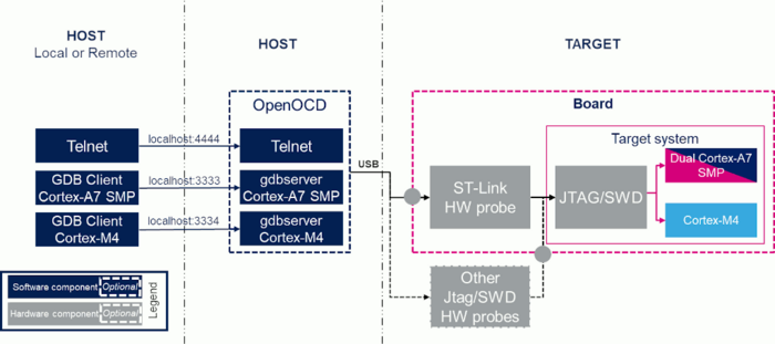

- Architecture
The figure below shows the architecture corresponding to the GDB/OpenOCD connected to Cortex-A7 and Cortex-M4 cores.
Note: The ST-LINK probes available on the STM32MP1 board can be used through a USB interface, as well as any other external probes through the Trace or JTag connector.

5.3. Debug Cortex-M4 firmware with GDB[edit source]
The Arm Cortex-M4 core firmware can also be debugged using the GDB in command line (without IDE).
Either engineering boot mode and production boot mode are supported.
Please refer to the Hardware Description (Category:STM32 MPU boards) of your board for information on the Boot mode selection switch.
5.3.1. Debug Cortex-M4 firmware in engineering boot mode[edit source]
As in previous chapter Running OpenOCD and GDB, both OpenOCD and GDB have to be started on separate consoles.
OpenOCD has to be executed in the same way as in the mentionned chapter.
GDB, instead, has to be executed with a different command line, without the script but with the path of ELF file containing the firmware to be debugged:
GDB PC $> source <Your_SDK_path>/environment-setup-cortexa7t2hf-neon-vfpv4-ostl-linux-gnueabi PC $> $GDB $HOME/path/to/file.elf# Second console for starting the
Then, the following commands has to be typed in the GDB console to start the execution of a firmware and halt it at the beginning of main():
main (gdb) continue(gdb) target extended-remote localhost:3334 (gdb) load (gdb) thbreak
Once the execution halts at main(), GDB will return the prompt allowing the debug of the firmware.
5.3.2. Debug Cortex-M4 firmware in production boot mode[edit source]
In production mode the firmware is started by Linux, independently from GDB. Nevertheless, GDB can set a breakpoint before the firmware is started by Linux; thus the firmware will halt at the breakpoint, allowing GDB to debug the firmware.
Please check in Linux remoteproc framework overview how to start and stop a firmware using Linux remoteproc framework.
At first, verify that no firmware is running on Cortex-M4 or, eventually, stop it.
Then, start OpenOCD and GDB as in previous chapter Debug Cortex-M4 firmware in engineering boot mode.
Type the following commands in the GDB console:
main (gdb) continue(gdb) target extended-remote localhost:3334 (gdb) thbreak
Finally, let Linux start the firmware. The firmware execution will halt at main() and GDB will return the prompt allowing the debug of the firmware.
Use on GDB command line the exact same ELF file that is used by Linux to read and run the firmware. If the files are not the same, the symbols on GDB will not match the firmware in execution. |
